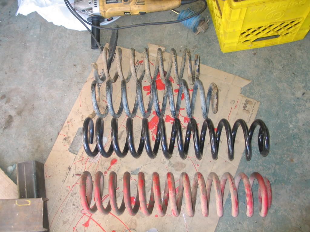

Finally got started installing the longarm kit onto the ZJ. Its super BEEFY!
Coils! Top to bottom, stock rear, stock front, my old XJ 8" Skyjacker, the new 7" ZJ Clayton's

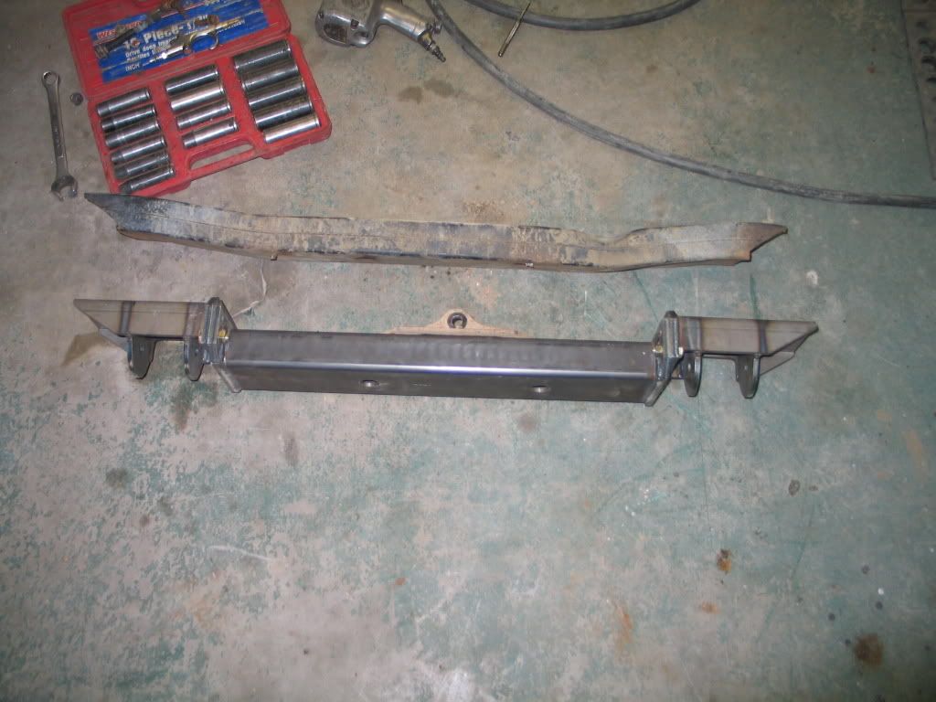

New crossmember vs stock, glad to have this my sister bent the one on theirs last year.

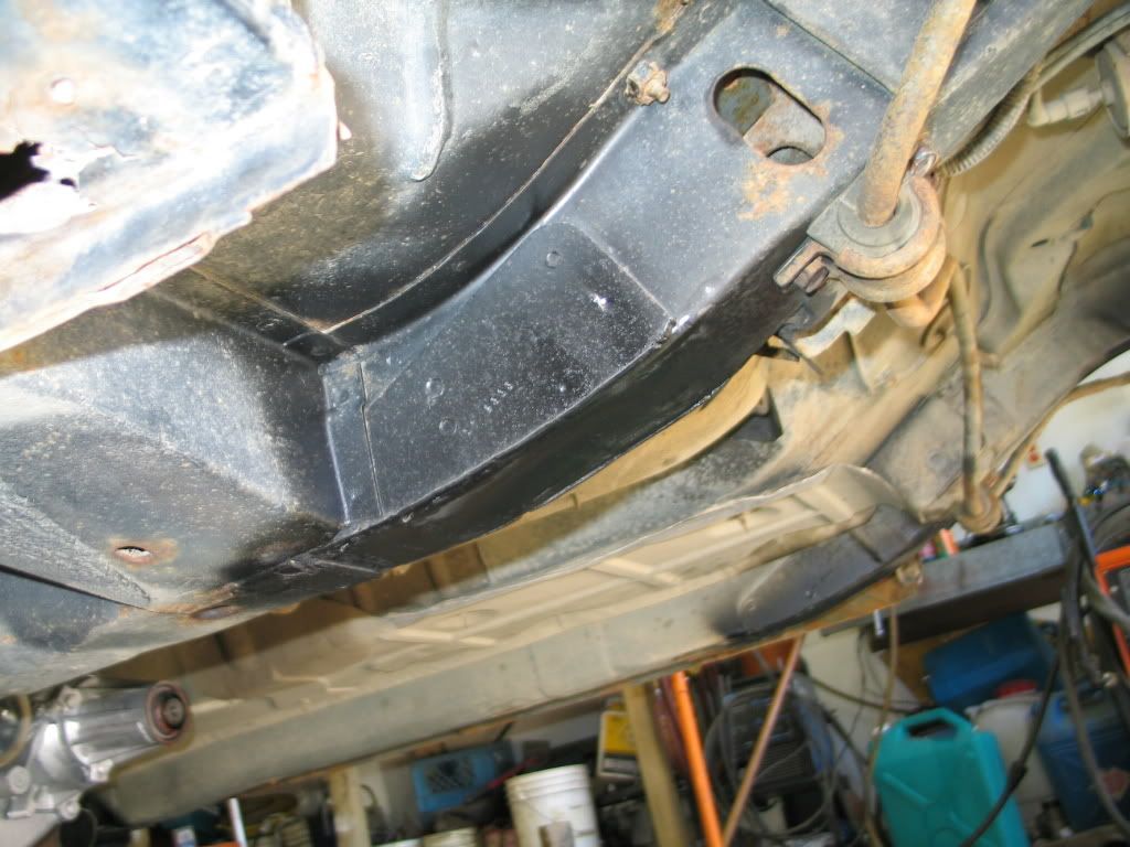

Finally got to use the plasma. Bought new tips for it gave it a tune up and it works great. Tip is a bit big and bulky for tight work but for what I paid I'm happy. There used to be a stock lower control arm mount here. A bit of plasma and a bit of grinding an all gone!!!

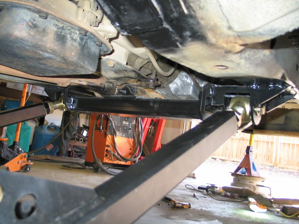

Now we are getting serious! New crossmember welded in and front arms installed.

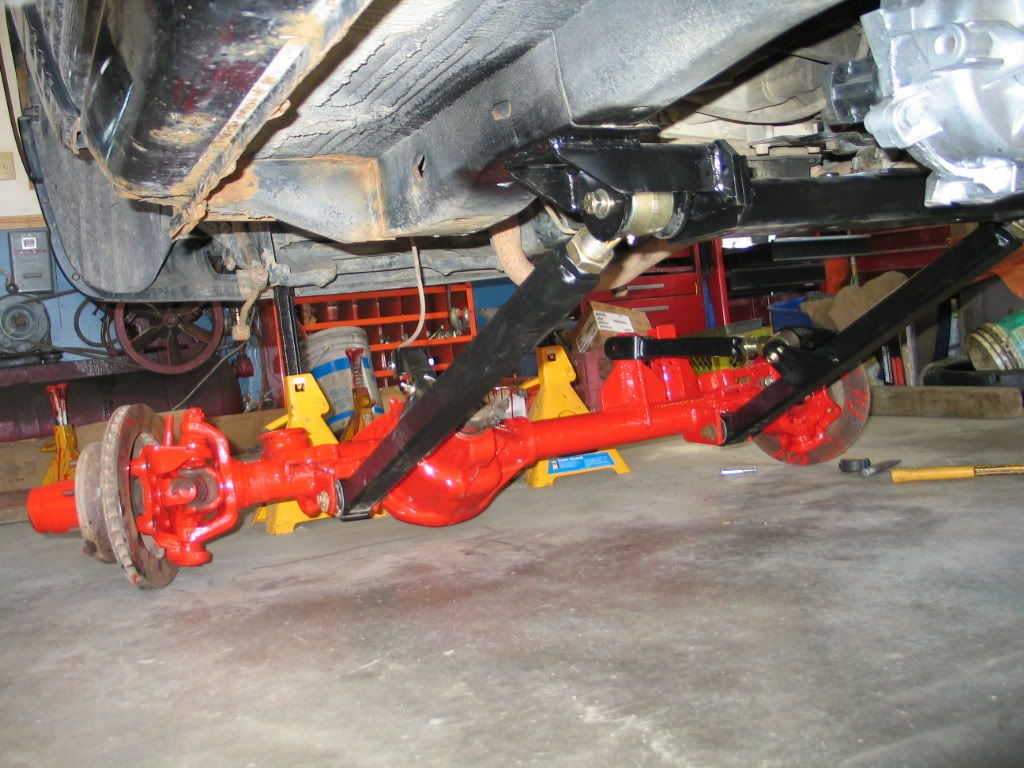

Custom D44 from my old XJ
Its actually bright RED, not orange.

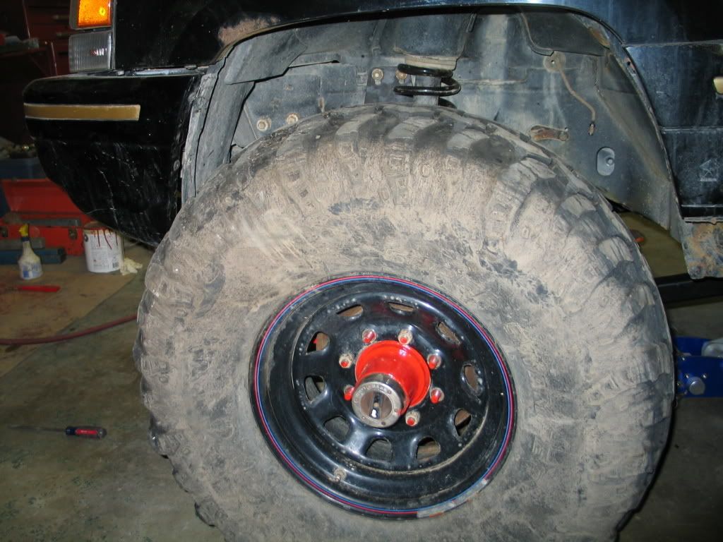

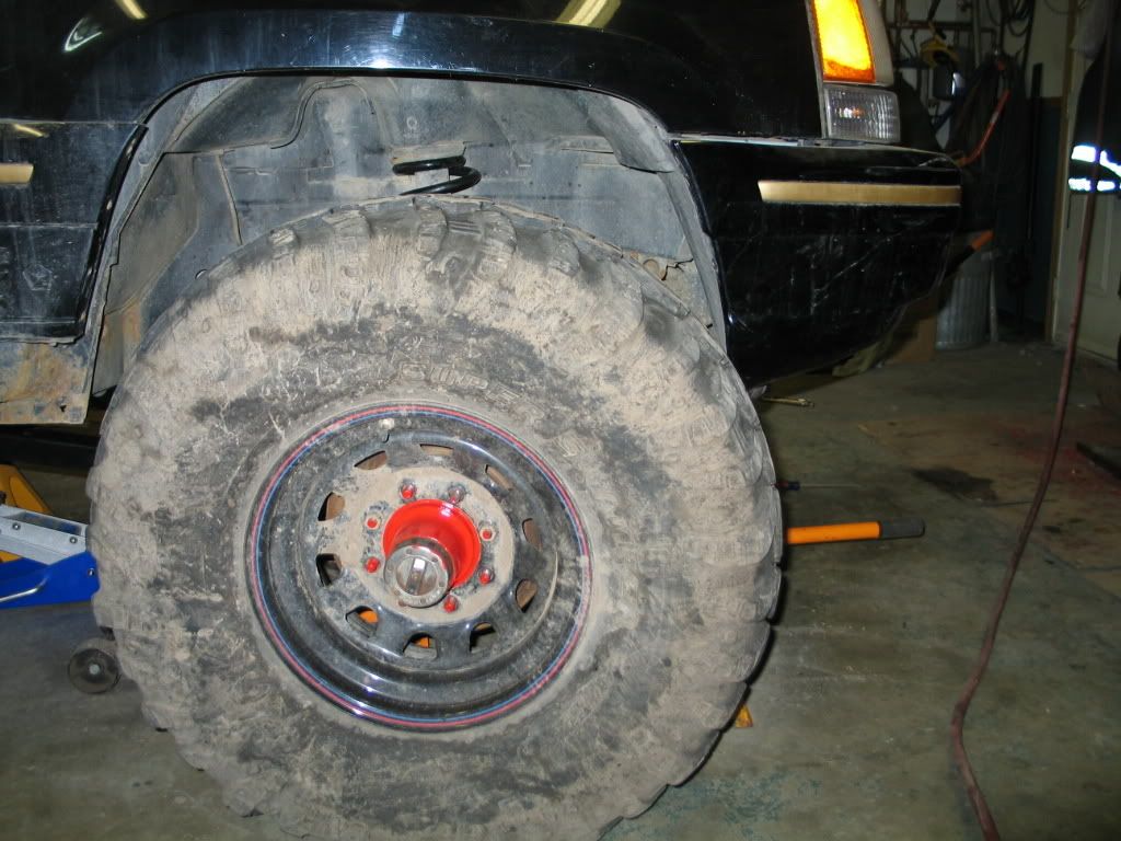

Not bad, arms need to be shortened a bit. The weight of the vehicle is on the tires, this will be the ride height minus whatever a winch bumper drops it. Tires are 36" IROKS.
