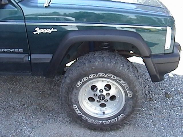

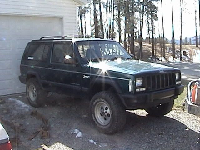

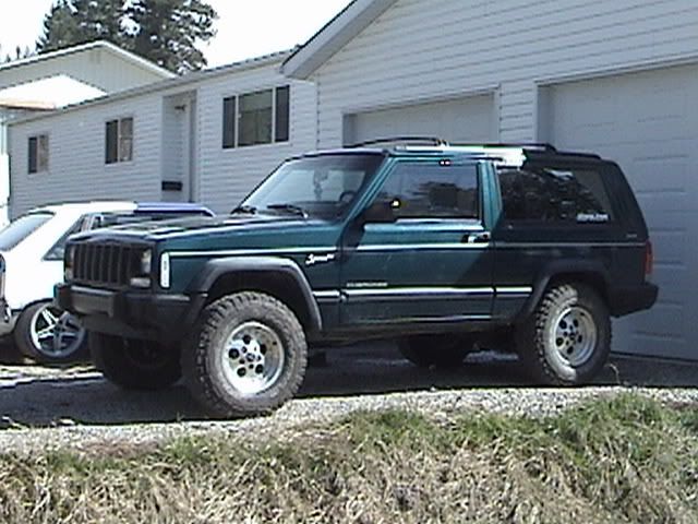

Bought this off of Craigslist in Calgary bout a month ago.
3" Procomp Coils
Procomp LCA's
YJ Front shocks
ZJ Rear shocks
S-10 Leafs
31" Wrangler MT/R's
15X8 Gambler Rims
And yes I know I need a little more in the rear. Gonna add a pair of shackles.
