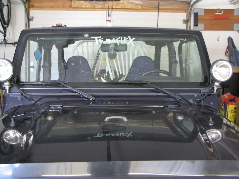

Here' s what I did with mine.
I drilled a hole on each side into the cowl.  Added paint and a grommet:
Drilled a hole into the engine bay... Once again added paint and a grommet:
Mounted a relay right there by the hole into the engine bay (on the TJ):
Ran a wire to the battery, one to ground, and one into the passenger compartment through a grommet in the firewall just above the gas pedal (sorry no pic).

« Reply #5 on: November 08, 2005, 10:25:45 PM »
Since I cant get my home email working those pics work.
I did the same basically. My mounts bolt to the two bolts right under the windsheild hinge, so I just brought the wires out of the seam right at the end of the cowel. Theres only a couple inches of wire outside.
