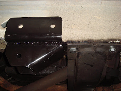

One more thing...if this isn't a good enough reason not to run blocks, then i don't know what is...
Hi, my name is Dan and I'm a Jeepaholic

I'd really like to stay away from any welding though (how much did it cost for the welding). My budget is around $1500.  Blocks were just a thought as i already have them... but my 31's would look pretty stupid with 6.5" of lift and I cant afford new tires and a lift at this point, so I'm going with the lift and waiting on the new tires.

Welding on my kit was minimal (free)...but the new style kit is completly bolt on...At $1500, I say you can come up with a little more to get what you really want. Sell your old stuff to recoup some of your cost.
