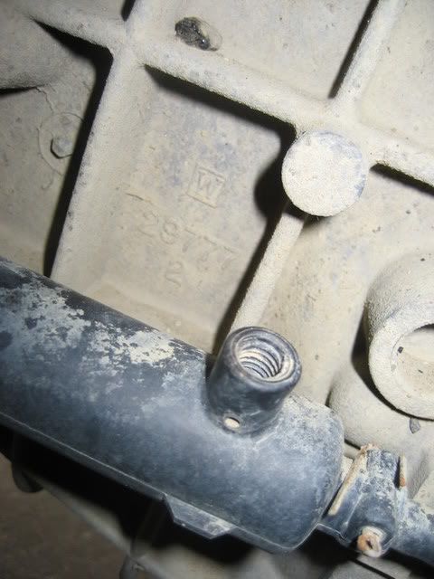

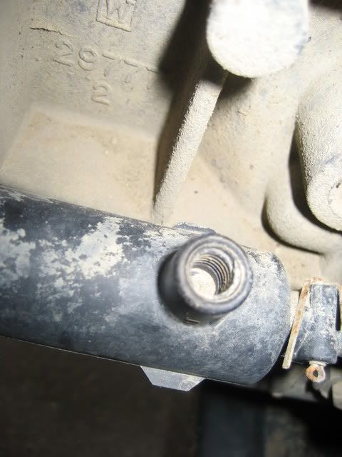

See the problem with mine was the slave did not have a proper bleed screw, so therefore could not really be bleed.  Mine could be different from yours.  Take a look at your slave and if there is just a hex head screw on top, my guess is you will need the whole system.
But like I said yours could be different, so do your homework.

« Reply #6 on: June 11, 2007, 11:36:19 AM »
Ok, snapped a couple pictures. BlackYJ, i think you are right, i see no bleeder valve, is this something that can be purchased that may screw into there?
