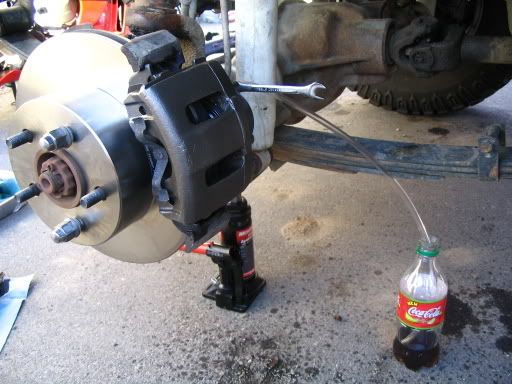

After I found and figgled with a hose to make it work to bleed them suckers, I found the Dot3 is a lighter fluid, whereas the Dot4 is much darker, I hope that doesnt bugger things up. Anyone have an idea on this?
DOT3 and DOT4 mix together, but neither mixes with DOT5. I recommend against using DOT3 as lighter fluid :lol:
Quote from: "Elsifer"
Where can I get some proper hose? The bleed nipple is a 3/8's wrench size.
I assume you mean hose for bleeding, not brake hose. I get mine at Home Hardware, but any hardware store or even Canadian Tire will carry 3/8" ID poly hose. I just poke a hole in the lid of a handy container for bleeding, like so:
