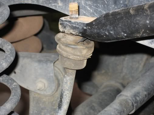

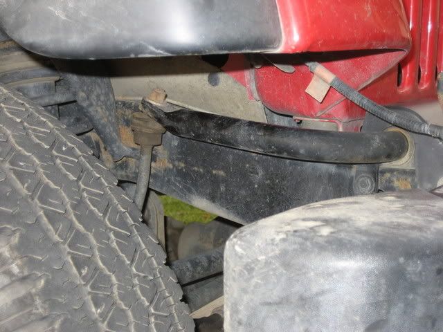

« Reply #12 on: October 12, 2006, 07:20:57 PM »
UPDATE: Pretty sure my rubber bushings are toast...
Pretty ugly, i think i need a cleaning down there too, lol...anyways, kevman, any chance i could follow up on that offer?
I also have a slight concern from these pictures. The one on the top is from 4x4xplor write up on JKS discos...the one on the bottom is mine...His seems to sit on top, whereas mine sits right on the side of the bushing. Is there anything to be worried about?

« Reply #13 on: October 12, 2006, 10:35:44 PM »
Looks like you might have a bent bolt.
Take it apart and see.
