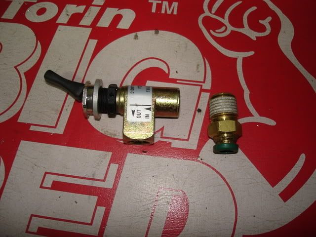

Here's the switches we used. They are 20$ at kenworth, the metal flick switch ones are 12$. Wolf359 tipped me off on where to get them.

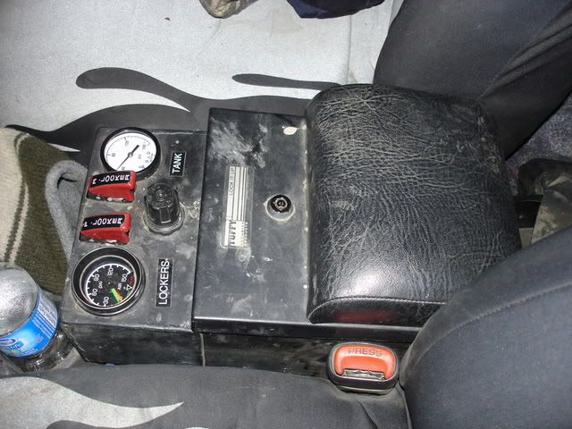

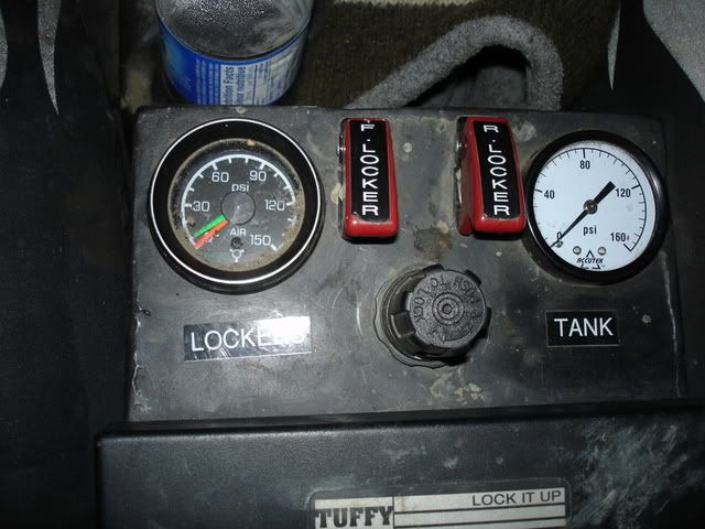

Here is the whole system. I built a sheet metal box and attached it to her tuffy center console. The white gauge measures the pressure her OBA system is running at, in the tank, before the lockers.

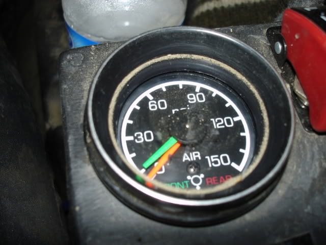

The black two needle gauge registers the regulated pressure of each locker when they are engaged. This is nice, as you always know what pressure your ARB is running at.
Close up of the dual needle guage.

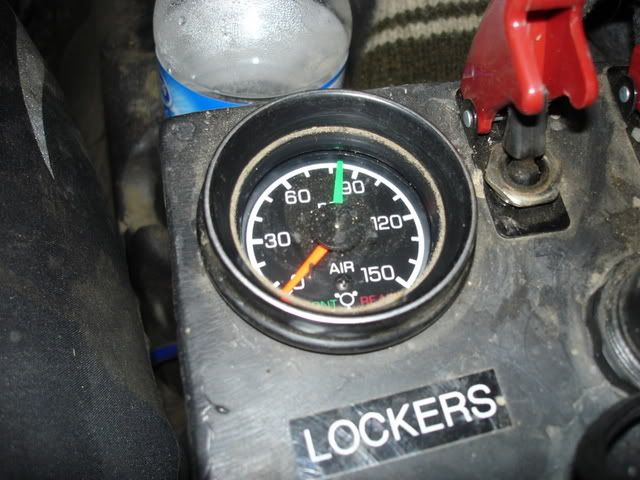

Front locker engaged, with the appropiate needle reading the locker pressure.
I converted all the air lines to a common size 1/4". ARB supplies their kits with 5mm line and fittings, making replacement stuff a bit more rare and expensive.
I did all the fittings using press in, like the one beside the switch in the first picture. Even the ones going into the diff housings.

I suspect there are momentary air switches available. But then there would be a need for another switch for venting. Or use the same momentary switch for releasing the pressure. But obviously the pressure before the switch would need to be less than what is after the switch.
In either case, somewhere there needs to be a relief valve/switch to release the pressure on the arb, to cause it to disengage.
compressor->airtank->airtools & locker(s)
So somewhere after the tank, and before the locker are the switches.
Based on the photo, those are a simple two-way valve. So also between the tank and the locker needs to be a release valve. Unless those fancy toggle switches are a three-way, then when the toggle is put back to "off" then the pressure is released, or they self bleed when moved to off. Or the knob is a bleeder of sorts.
Exactly
There is a tiny hole in the black thread portion of the switch that automatically bleeds when the switch is in the off position.

Your setup looks nice.  The dual needle gauge is a great idea.
