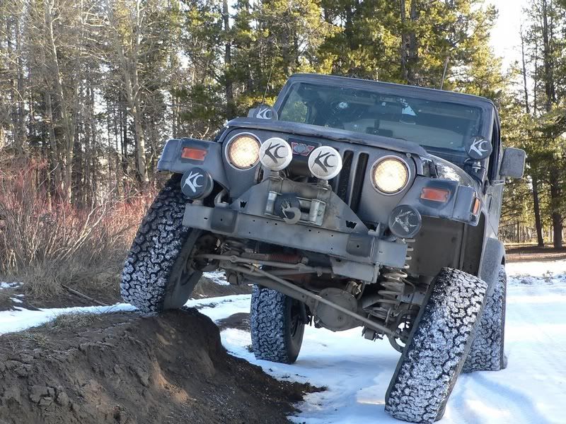

Ok here,s my 2 cents
I run BFG 35" tires , a 2" body lift and drive 160+ Kms daily on the highway I have a 4.5" rubicon express super flex kit with 3.5" springs
Rubicon express spring always give a little more lift than advertized
The 3.5" springs give about 4 to 4.5" of lift
The 4.5" springs give about 5 to 5.5" of lift
By getting the 4.5" superflex kit u get adjustable upper control arms for all 4 corners so getting the rear pinon angle and the front caster set is easy
The 4.5" springs in my opinon give to much lift for a short arm kit and make for a rough ride
So I would recomend the  RE 4.5" SF with 3.5" springs
That being said a lifted jeep will ride rougher than a none lifted jeep because of the geometry of the control arms
Steve
edit
It sounds like ur building my jeep :lol:
