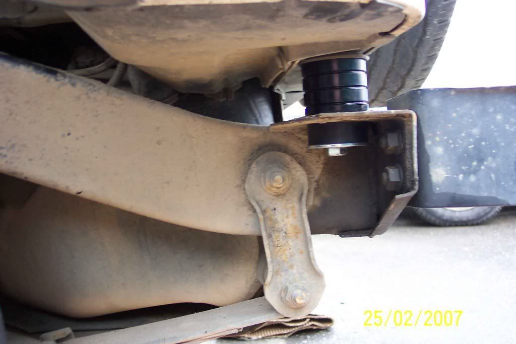

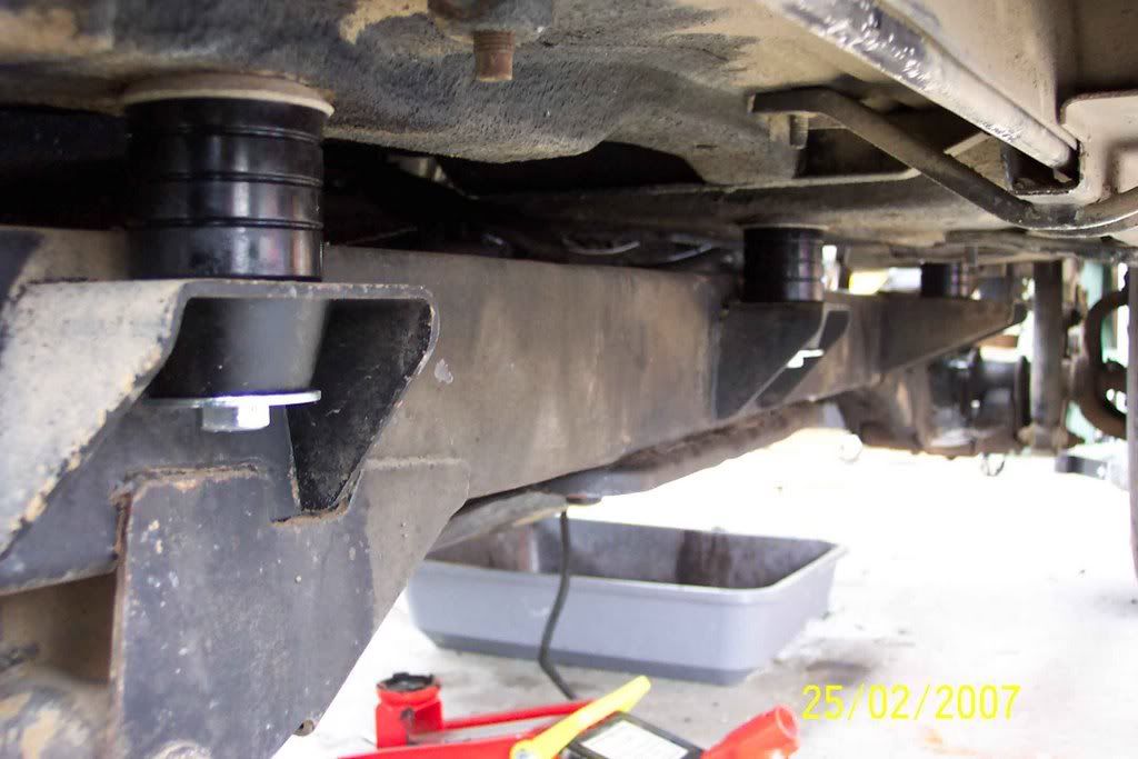

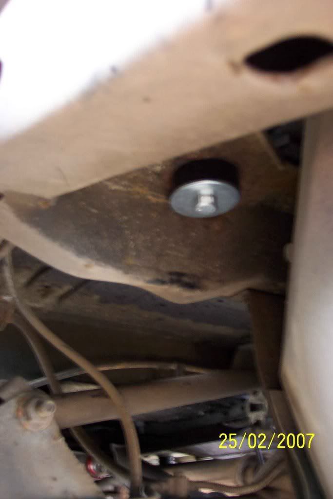

Thanks for all the tips and suggestions! I have it completed and i read the instructions that came with my kit and it dose not state either lock tight or never seize so i did as it said and used neither but i did use the torq wrench as they said to factory specs.. :D if i knew how to put photos on here i would............
the 1" lift actuall lifted my jeep almost 1 3/4" the old body mounts must have been compressed alot.  :wink:

« Reply #8 on: February 25, 2007, 01:52:16 PM »
Think i got this figured out to post pics       [/img]
Yup i think it's got er done! :lol:
