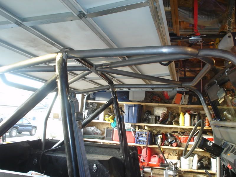

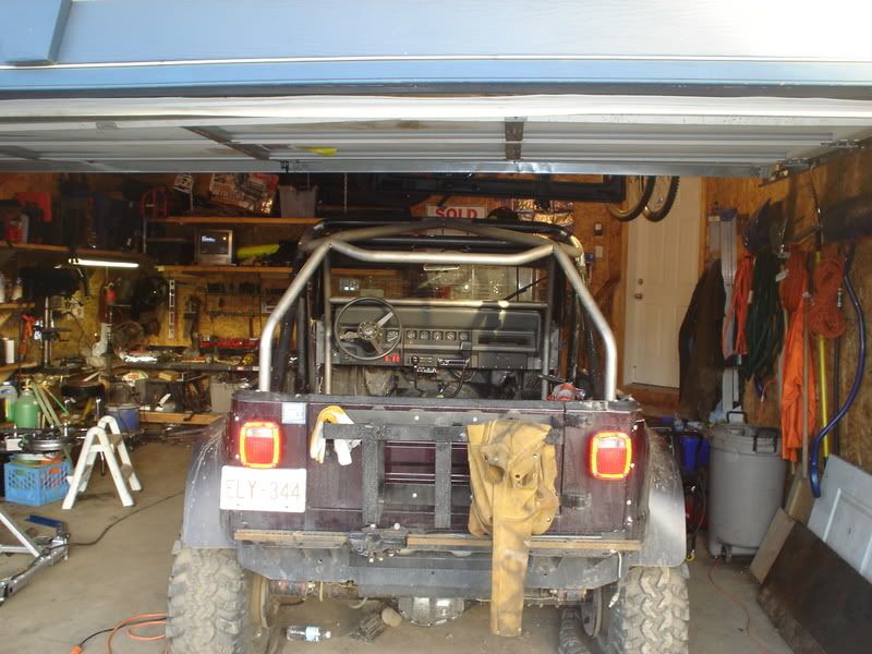

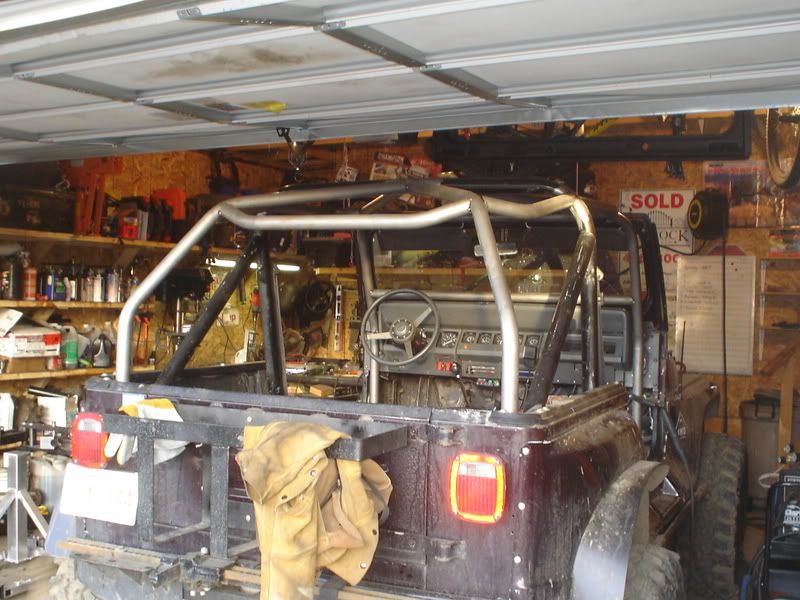

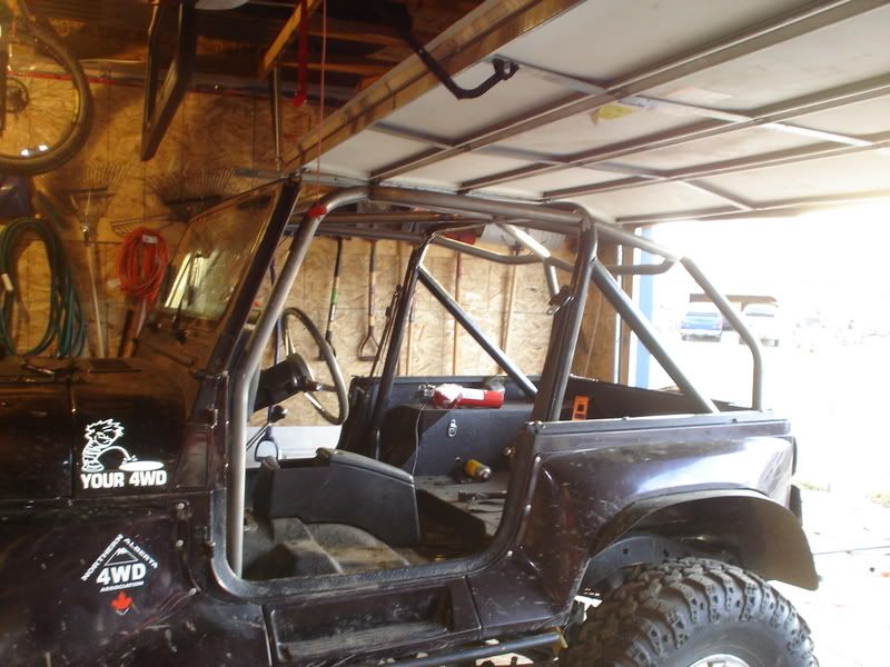

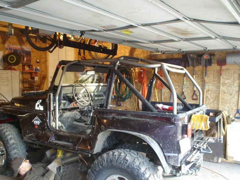

Here's what I've been up to for the last day or 2.  Gone together sweet.  And Kole's  been a huge help while building it.
 Can't imagine how much longer it would have taken without him around.

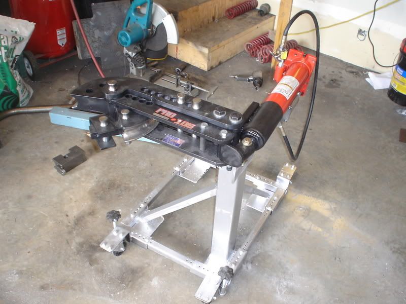

Very creative ,  what type of bender are you using ?

I have a protools 105hd that I added hydro to.

Where abouts did you pick up your tube bender? An affordable price I bet....

ProTools has lots of vendors on the net.  Or a guy in Olds sells them sometimes.  Haywire on the sites.
Sadly I don't think theres such a thing as an affordable bender.  I have plans to build your own actually.  Still uses protools dies.  Trouble is the dies are the priciest part of it all.  Expect to drop in the neighborhood of $1500 to get a bender with one die, a stand and hydro of some kind.  If you wan the protools hydro the price would go up by about $800 or so.
I'm actually making my hydro conversion for several shops right now.  Everyone saw it and want one.
If it is you want a bender give me a call and I'll get you hooked up, or point you in the right direction.  Same goes for anyone wanting to add hydro to a protools bender.

Tempting ........... buying a bender ,  I should resist the urge though , there's way too much crammed in my garage as it is.
I do have some tube work that needs doing , right away . Not a whole lot , .....................  rock rails , small stinger and rad / grill protection , framework for my seats / tied in to cage. I have tube but no bender , I'd be happy to l pay for your time or barter for machining.
PM me if interested

Eric, how hard/how much to convert to hydro?? A guy wouldnt want to convert a 105 to hydro due to thickness of arms?? Only 105HD should be converted?

Joey....I see no reason to not convet the reg 105.  Only difference is the thickness of the arms.  Just don't try to bend .25 wall or something like that.
Give me a call if you need the hydro.  I'm doing them up for a number of guys right now.  $350

Looks good bud. The bender setup is pretty sweet.
