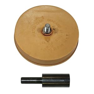

screw the heat gun, scraping, and peeling. Go over to C-Max (right next to the NAPA in the NE near the Hooters), get a rubber eraser wheel for use with a drill. Use it exaclty as it sounds. Works exactly like an eraser. Use a little brake clean or other solvent to clean up any left over glue residue. I used these things years ago when I worked in a body shop, and have sworn by them since. I've even used them to strip entire decal packages off of fleet emergency vehicles.
Wear safety glasses. It works like an eraser does with a pencil and you get little flakes of rubber all over. If you have alot of decal to remove, I'd suggest "garage clothing". Also, when they wear down to the line, don't think you can keep using them past that point as you'll quickly find the plastic/metal plate in the middle for support.

Buy and use an eraser wheel - I had a ton of decals all over my jeep and scraping and goop remover worked on some but removing desert baked ones resulted in damage to my paint underneath (just took the shine off but still looked crappy)- the eraser wheel takes the decal and the glue off very well with zero damage.  I've taken about 10-15 decals and still have half of the eraser wheel left - they are well worth the invesment - just watch the heat, if it gets too hot it just pushes melted glue around instead of taking it off.
I found mine at Napa for about $28 - seemed expensive so I waited and sure enough I found one in the Golden Napa on sale for half price - after using it I would pay 28 bucks for another one if I needed it.
