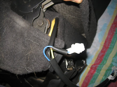

Remove seats to find 6 yrs worth of junk:
I removed the entire seat/slider/brkt assembly.  This will take a T47 Torx bit that is the devil. Just take your time.
I left all the brackets on the seat.  Start with the seat bottom, and remove the long clip for the cover in the front, followed be each side clip. I used a small screwdriver to start the clip removal.  Its tough, but can be done.
Start to fold the seat cover back over the foam and you will encounter hog rings connecting the front to back side bolster divider to the seat.  I used to sets of needle nose pliers to open the hog rings. (There is also a velcro strip that runs left-right. Separate easily so you dont tear the velcro from the foam.
Slide the seat heater into place. (Dont pull the paper back yet)  Feed the power connector through the back of the seat. (Remember to exit the side of the seat towards the center console. NOTE: the kit includes enough cable to route the cable around the interior 3-4 times..)
Once satisfied with the placement, fold the seat heater back and start removing the paper backing from the rear of the seat forward.  The kit is very clear that ALL paper must be removed from the back of the element.
Note: Pad must be to the rear of the lower seat cushion, to avoid the velcro strip.
I used high tensile zip ties to replace the hog ring clips.  I have used new hog rings in the past, and I think zip ties work better.
Take your time, and work your way back to front.  I tighten the zip tie and reach in and cut the excess.  Then roll the zip tie down so the cut end is facing away from your rear. (Similar process used for hog rings)  The rods in the seat cover need to have the ends contained in the pockets on the cover, and are free to slide.  Just make sure they end up the way you found them.
Pull front and side clips through the brackets, and clip into place.

Re-install the seats.  Its important to have the seats in to check for proper routing of the wiring.   (I took the time to also clean out the floorboards)
Wiring is straight forward.  There is a lead wire with connectors that connects the seat  to the control module.  I routed them under the center console, with the connector exiting just under the cup holders to each seat.  I checked for full movement of each seat.  I mounted the module just in front of the 4wd shifter, out of site behind the console where the CB is mounted.
