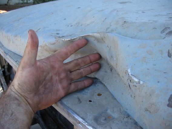

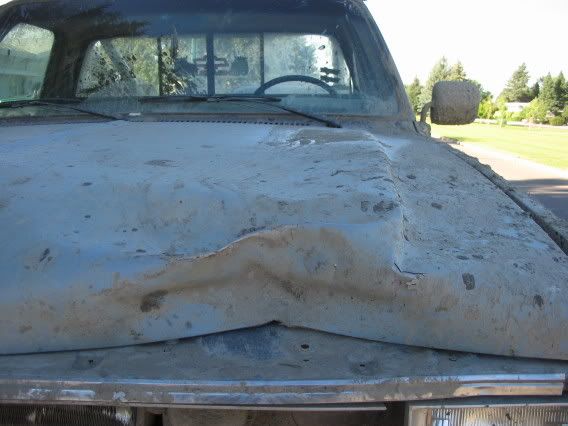

I would definately get the 3"x30', you don't want to have to put a clevice between two straps. Heres what happens when a strap breaks with a clevice between two straps.
Sardaukar
Recovery Strap
« Reply #6 on: October 05, 2006, 04:40:27 PM »
DAMN!!! that is scary!

Quote from: "whitetrash96"
The driver of that truck should realize just how lucky he was that clevis wasn't flying 2-3" higher, it would have been a whole different story.
And don't think for a minute that just because you use a strap with no metal hooks or clevis's that it can't cause similar damage, There was a video a while back that featured an S-10 pulling someone out of a hole with just a strap and the strap let go.
It caused similar damage (as the picture above) to the tailgate and continued through the back window and landed on the dash (I can't recall if it broke the windshield or not).
Now, any more than a simple tug, I break out the winch, especially if the stuck vehicle is heavier than mine.
