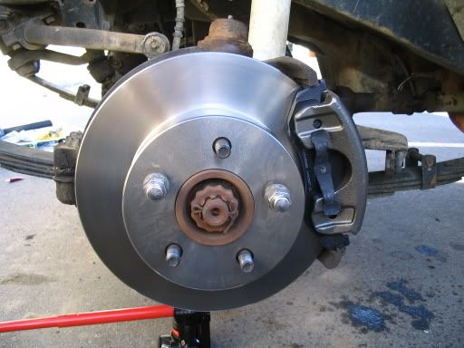

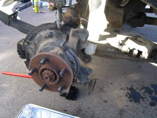

First remove the wheel, caliper pins and caliper. You can see the old caliper set out of the way on the leaf spring.

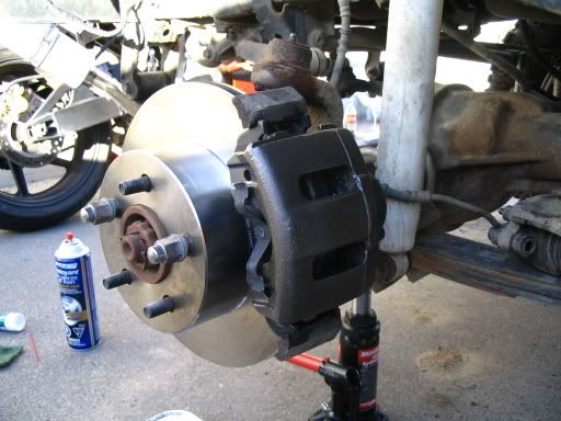

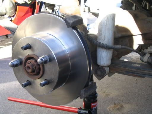

Install the new rotor with a couple lug nuts to hold it on. The rotor was coated with a sticky film from the factory. Some brake cleaner got rid of it.

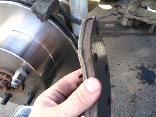

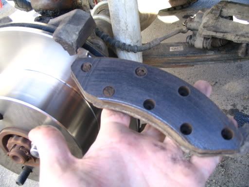

A shot of the old pad. The pad is drilled, and these holes were full of mud and dirt.
Here you can see I had a lot of pad left, but I figured it was worth it to use all new parts.

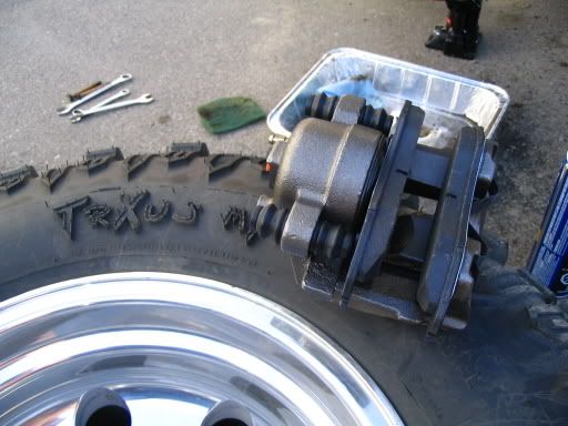

New caliper with pads installed.

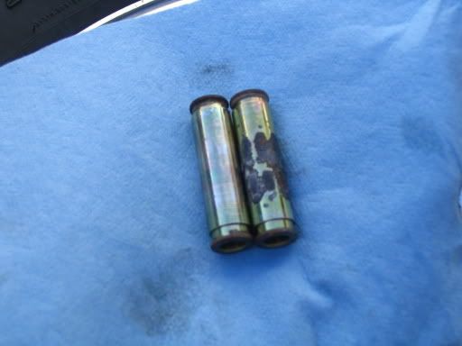

3 of the 4 pin bushings were in great shape, I'll be ordering a new one tomorrow. The new calipers came with the piston, seals and pin boots, but you have to reuse the pins and bushings.

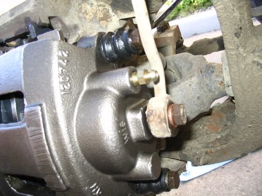

Connecting the banjo bolt. The new calipers came with new copper washers.
