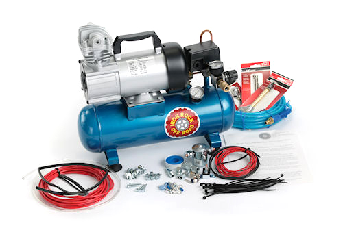

Bang for your buck I am seriously looking at this unit
http://www.ironrockoffroad.com/Merchant2/merchant.mvc?Screen=PROD&Store_Code=IROR&Product_Code=IR-A_ACK&Category_Code=A
This air compressor will fill tires faster that any Viair, faster than the Quick Air 1, 2 or 3, and faster than the Extremeaire!
Output: 3.4 CFM at 40psi and 3.0 CFM at 90psi
Dimensions: 18" long X 6" wide X 15" tall
Weight: 28lbs
Pretty sure you could probably find the exact same compressor they use on ebay or something for less money, still is convenient though.
« Last Edit: February 09, 2012, 11:59:16 AM by Jrama »
Re: Anybody done DIY on-board air system
« Reply #43 on: February 09, 2012, 12:31:15 PM »
So you have to wonder, how does that comrpessor put out 3 cfm at 90 psi with only drawing 30 amps, and the extreme puts out 2.6 cfm at 100 while drawing 95 amps, and compared to most viars that put out just shy of 2 with about 25 amps.
Do you want to know how? I'll explain. They are all pretty much the same thing with minor variances in sizes and reporting stats. At the end of the day, just get the cheapest one you can find cause they all do the exact same thing which is make a bunch of noise and fill your tires very slowly while you shoot the crap with the guys at the end of a trail run.................lol
At least that ironrock has a wee tank on it and puts out a little more then a big viar.
